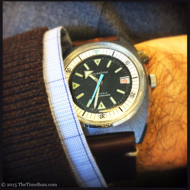

As far as I can tell, Majestime made dive watches in the 60s and 70s. This one is a dual crown, barrel cased diver with an internal timing bezel. The case is plated base metal with a stainless steel back and measures 37mm wide and 45.6mm long, arcing and tapering to 20mm lugs. The sides are shiny and beveled, creating two nearly congruent surfaces. The broad upper surface has a radial texture that highlights the curvature of the case. Finally, a thick, flat acrylic crystal towers a full 3mm above the case. It is a dramatic design. I only wish it were stainless steel as that would have weathered the years without the significant pitting and flaking now afflicting the back, sides, and crowns.
The dial is marked with three triangular markers and a quadrilateral date window at 3 o'clock. The triangles and their accompanying baton markers are applied, polished, and filled with a green luminous paint. The hour and minute hands are the familiar arrow and baton, and are similarly treated. The paint will still fluoresce under UV light, but has long since lost its glow. A thick, sky blue second hand lends an unexpected pop of a rather uncommon color. While it is all perfectly legible, it is a small dial, only abou 23mm inside the silver internal bezel (which incidentally, still rotates smoothly).
The movement is a 17 jewel, hand wound unit, most likely a French made Parrenin X170. Despite its age, it is keeping good time, losing less than one minute a day. The date wheel alternates red and black, which is a fun touch, but it sadly lacks a quick set function.
While the watch has all the styling cues of a diver, neither crown screws down, and there is nothing to indicate its water resistance except the scuba diver illustration on the case back, who appears to be swimming with an upside-down fish. Given its age, this is a moot point. However seaworthy it may have been back in the day, it most certainly is no longer. Like all of my retired dive watches, it now wears a leather strap. In this case, a tapered Horween Chromexel with minimal stitching from Vieux Halloo.
